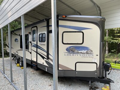

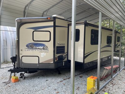

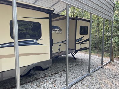

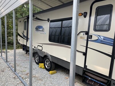

The trailer I purchased was not kept up very well. It was used as a hunting cabin for several years. The outside clear coat finish was gone. I had learned years ago that a cheap way to bring back the shine was using Zep High Solids Floor Finish. I can’t find it anymore it was replaced by there high traffic product. I now use there “Wet Look” product. It requires a few more coats, but you get the same result. I use it over the graphics, window and door trim And also the floor. Works great.

I'll try that. Thanks. Your RV looks good.
