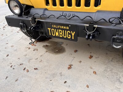

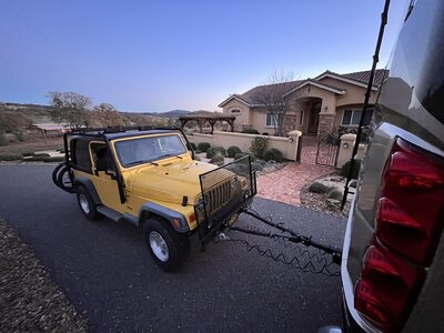

I have to agree - I’ve never liked conventional base plates. The connections just seem so small, even minimal to me. That’s why I built my own mounts and bolted them through the bumper and into the front cross member of the jeep frame. If I were using a typical base plate I would have probably opted for the break away braking system too. They just don’t look stout enough to me. This is also why I used a receiver extension with a 6” rise to keep everything level. I also used them to mount my rock screen to stop the damage to the jeep.
Through bolted mounts
Receiver extension with 6” rise to make everything level. Not a great pic of it but you can see it there. Also used hitch tighteners to keep the receiver extension from bouncing around in the hitch.
