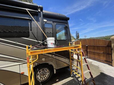

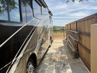

Well you got my curiosity up earlier so when I moved my scaffold I plugged in and went inside and turned on the AC. It was 103 outside in the sun, 93 in the shade, 91 inside the coach.
I set the zones on 78. That was at 2:30. When they shut off (if they do) I’ll let you know how long that took. The air coming out of the vents is 63 degrees. So theres some data to mess with. One thing to keep in mind is that I have good insulation and dual pane windows (Newmar!). Back to work…..
