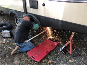

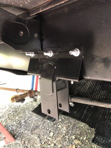

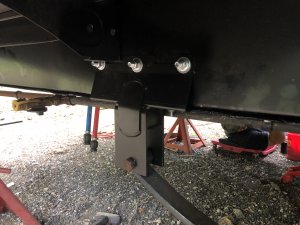

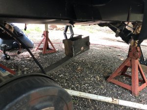

So I finally made it home about 11 pm last night. It took the repair tech about 5 hours to grind off the old hangers and install the newer ones. Apparently the hangers he put on my camper are the new design that will be going on the front and rear leaf springs as soon as the manufacturer can do a change over. Only issue with the install was he broke my Propane gas line off on accident and promised the company would cover the repair costs. All done right at the campsite.

That looks like a big improvement over the old mounts. Did the repair tech weld plates into the holes where the old mounts tore out? I would think that would restore the integrity of the frame rail.
TJ
Where they tore off was actually the hanger that was welded to the frame. He torched and ground those off, then spray painted the frame to look like new and proceeded to attach the new hanger to the frame.
OK...a closer look at your photos shows the hanger. ? The new mount looks like a much better setup.
