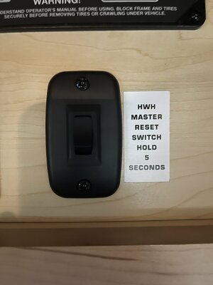

For no 4, you might want to post a picture, to be sure. there are some original switches and some that newmar added to deal with HWH issues. a picture would help to ID what exactly you may have.
For #4 I've read that Newmar added a HWH reset button due to the number of glitches they were experiencing
I can confirm the reset switch being added. Our 2022 Superstar has an HWH reset switch where all the controls are.
It is labeled as the HWH reset switch. Momentary switch.

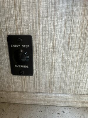

#4 may be the entry step override switch. It is the only round one on our Superstar and looks similar - may explain why the hydraulics start.
