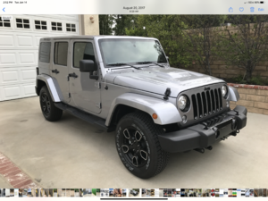

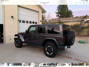

Looks familiar ?
Looks familiar
In my opinion the 2020 fixed everything that I didn’t like about my 2017, better ride, better view, rear view camera system, blind spot monitor, larger tires, 8 sp transmission, transfer case indicator,

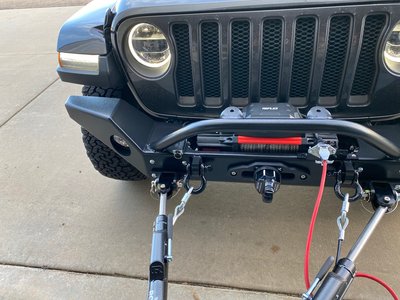

As for towing, I’m going a different route this time and getting a RockHard 4x4 bumper with BlueOx tow bar mounts and adding a Warn winch.

Thank you Turbo for the use of your picture.

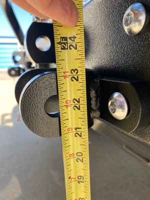

Here is an illustration of the differences in the two types of tow mounting points
