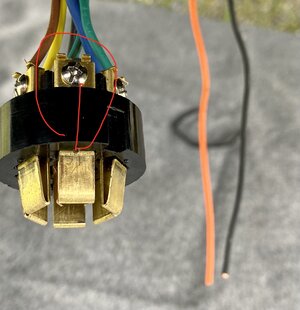

I was able to look at the 7 pin per Jabber Jaw (thanks) see pic … there is no wire connected to the power pin but per my dealer (beckleys in Maryland) The new Ford F53 chassis does not provide an auxiliary power wire to the 7 way plug … he had the same issue with a coachman
Also note there are 2 disconnected wires that read no power … don’t know where they come from ….

Just stumbled across this post. On the F-53 chassis Newmar does run 2 spare 12 gauge wires (orange & black to the 7 pin. there are folded back & taped inside the split loom tubing at the 7 pin. They can be found up front to the left of the brake pedal next to the side wall down by the floor (same vicinity as the ford brake controller plug). You can use an open fuse slot on the fuse block on the left wall wall to power the 12 volt charge line on the 7 pin. it must be connected on both ends, about a 15 minute job.
I did discover these. Dealer indicated wire gauge not adequate for him to do the job using the orange or black wires … ran a thicker wire to harness.
