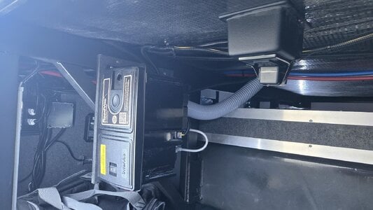

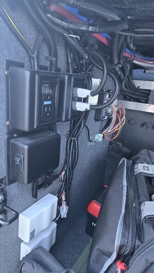

I looked in the slide out panel. It's full of lighting controls. It's not above that panel either.

Did a 360 look around the vacuum. Nothing.
The back wall is full of control boxes but not the one I'm looking for.

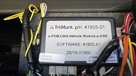

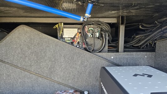

I had no wait time. Spoke with a gentlemen by the name of Chris. He knew by my phone number my name and what model Newmar I was calling about. He emailed me a picture of where the Trimark module and programming button should be. It's in the first passenger compartment behind the door. See attached photos of my set up.
Thanks to all for your input and help. Hope this info helps others.

Looks like they hid it behind a panel 😊
