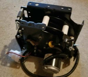

I ordered a new power Glendenning RLC power head assembly from eBay for $350 incl. shipping. All I need is to make a mounting bracket, and find a cord storage pail for the cord.
Also I'm using the cord from the failed reel.

I am not sure that the coiler actually turns the cable to coil it. I think it is the bucket that coils the cord and the mechanism just pumps it in til you tell it to stop. When we bought our rig I said let's go for a drive and I saw the seller gather up the power cord and stuff it in the power bay. Hmm. I had seen the tub and coiler in there. It ended up being a popped CB on the wall behind the tub - love those easy fixes.
Well regarding the "coiling "function here is my experience. I bought the same power unit that @Bully has purchased. I mounted the unit on a bracket about 9" from the side wall and as high in the electric bay as I could put it. I also used the power cable that was in the reel. I built a box that is about 15" square using the bay side wall and back wall for two of the sides. When the cord is run in with the RLC "coiler" it naturally coils up under the unit. I agree with @RKins the power unit is not doing anything other than "pumping" the cord in, i.e. it does not have any "spin" or "coiling" action in the mechanism. The "box" I built does not appear to be doing anything to contain or force the cord to coil up. It does keep me from putting any other items in the area where the cord will be coiled. I have a pretty big electric bay in my 2015 Ventana but it appears to me the coiler should work just fine in a smaller bay. You might want to give it a try without any bucket or box below to see how the cord behaves.
