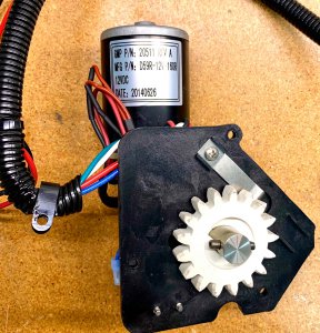

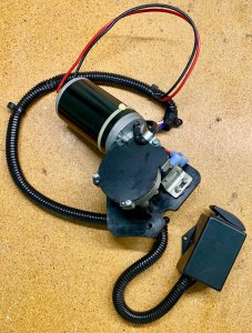

Today I took apart the failed reel, and now I understood why they are not selling the failed contacts assembly as a spare part. It is a huge job to remove and replace them. I bet just the labor (if you hire a service shop) will be more than the new reel. Don't know who designed this equipment, but it is extremely complicated with great number of complicated to produce components, for doing such a simple job as coiling a cable?
I saved the motor and switch with incorporated relay. They all look new and wired together. All is needed is to connect the Pos and Neg wires. If someone wants them, you can have them for FREE. just pay the shipping, Around $12 by USPS Priority flat rate box.
