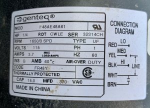

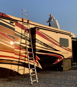

This morning early I gathered all my bravery, and took my 250 lb carcas on top of the DS, using my brand new 18' TeleStep ladder. Opened and inspected the #1 AC. Looks like the bearings on the electric motor of the blower are going bad. It starts if I push it with my finger, and then makes more noise compared to the other AC. Took photo of the label, and will look for replacement. Two AC's don't cut it at temps over 100F here in Las Vegas.
Now about the ladder:

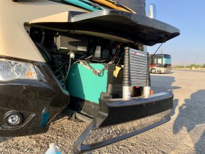

Thank you skychs and Neal for suggesting the 1800EP . I like it. Very well made, and fits in front of the generator.
What I learned is, not to extend more than one section above the coach. I had two, and was difficult to step on the roof, having to move around the two sections.
Prop the ladder between the two extended slides. Gives you some side protection, and option to step on the slide or grab on to one in case of a screw up.

Now the bad news. Can not find a motor anywhere. When they told me it is 8 weeks waiting time for parts, I thought they were coming on the "slow boat from China".
I was right. They come from China, and no one has them? Not even a repair kit to replace the bearings (most likely bushings).
