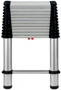

Hi Neal. My question is: When you prop the ladder to the side of the coach, does it stick a little above? It helps when you are trying to get down.
Jul 27, 2019
3,355
Midlothian, VA
Ventana 4037
40' 10"
2017 Chevy Colorado
I don't recall it not being tall enough or a concern. Specs say it's 12.5' long. Add "noodles" to the area that touches your coach. I used it to get to the top of my windshield to install @J&JD's gutter mod. I did not use it to get on the roof as I have a ladder on the back of mine for that. Maybe others can chime in as this seems to the popular one among the Newmar community.
