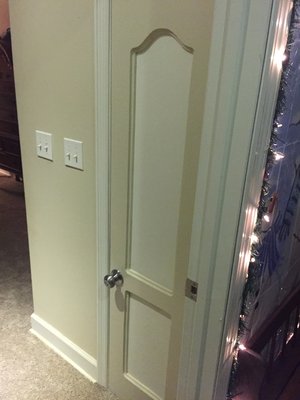

Class c, queen bed in back. I will build the door with 1/4" ply and 1X trim and stiffeners, I have built several custom doors and they have come out really well. I thought about a curtain or accordion door. Susan wants a wood slider.....Susan gets what ever she wants :) . I will try the stud finder and see what I come up with, thanks for the idea on that. here is a picture of a custom door I built for a under stair closet in our home
