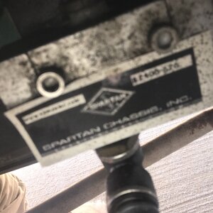

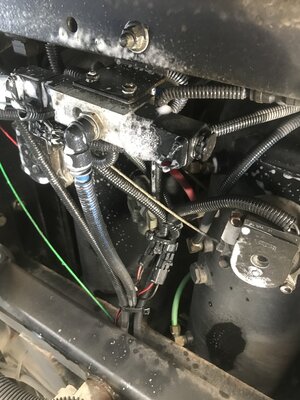

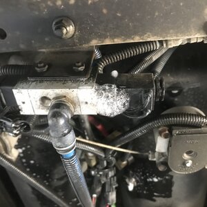

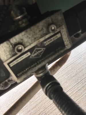

Found it but what is it. Lol

I don't know but I would call Spartan and send the pics if necessary. I bought the replacement moisture ejectors and ride height valves from them.
Happened across this Spartan air system diagram from 2001. The solenoid valve looks to be closest to what is in picture of question. Also, you can reach out to Parts & Accessories - Spartan RV Chassis
Ordered new valve master dump #2538-MM5-001 called Spartan and confirmed part used on chassis build. Should be here Thursday. Will update. Thanks for all the help
