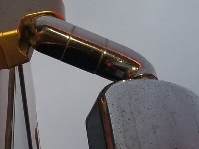

Does anyone know who makes the mirrors newmar is using?
The driver side mirror has a very short arm. Like to try a longer arm, so I can swing the mirror to the front of the coach vs by the driver side window. As it is, I have to lift my head and look up to check the side view. This is not very functional
thx

I had to replace both a mirror and a mirror arm when the rig next to me in storage didn't pay attention to their tail swing. I went into vapor lock when I saw the Newmar prices for replacement. Ramco's prices were much better, they were easy to interact with, the replacement mirror and swing arm was shipped in excellent packaging with more than adequate protection, it was an easy install once I was able to break the existing corrosion around the tightening bolt and mount free.
Advice:
  • Start soaking the swing arm mounting bolts in lots of penetrating spray sooner rather than later...
  • Once you remount, use small pieces of pinstriping across the mounts and swing arm joints such that if you ever have to move the mirror out of the way you'll know exactly what position to return it to later.
Best,
-Mark

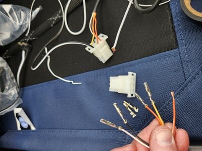

Thank you for the heads up. yes they are frozen, tried adjusting them and no movements. working on that.
did you have any issues with the wiring?
I had to replace a mirror on another unit (newmar) more than a decade ago and had difficulty getting the wire/plug re connected. The wires went across the front (firewall) of the coach. when they were spraying the foam for insulation on the front wall, the wire was pulled tight! Ended up going back to the factory for them to remove the foam to get wire for the mirror freed up, so it can be reconnected inside the mirror.
I didn't have any issues. Perhaps I was lucky based on what you shared as my connector wasn't buried in spray foam. Below is from a previous post I made about the mirror replacement. The following may or may not be relevant as my mirror arms had turn signals built into them. If I recall correctly, the connector was tucked into the swing arm mount outside the rig. I extracted the paragraph about the wiring (Neighbor broke off mirror arm):
The next thing is that Ramco makes connecting to the coach wiring harness a breeze. They ship the mirror with all but one of the wires preconnected to the pins that insert inside a plastic 6 pin connector. The only wire they don't preconnect is the one that also gets crimped with the white wire from the turn signal in the arm. They also supply you with 2 pins such that you can crimp the open orange with white stripe wire to the white wire from the blinker light. The 2nd pin is then for the black wire from the turn signal. Finally, because the pins are not inserted into a connector it gives you the option of using the connector they supplied with the mirror or perhaps reusing the connector body from your damaged mirror if a different type or pinout configuration. The connector was the same as what Newmar used so I just inserted the pins into the right holes in the connector body they supplied making sure the colors matched up with that of the damaged mirror.​
Best,
-Mark

Thank you for the info. After discussions with Ramco, it turns out the wiring on this mirror is different due to the memory option for seat/mirrors, etc. At an opportune time, have to take it apart and see what's involved.
If there is any consolations, the front windshield is cracked and needs replaced. That requires removing the inside cover for the column. This may provide an opportunity to have better access to the wiring going to the mirror.
