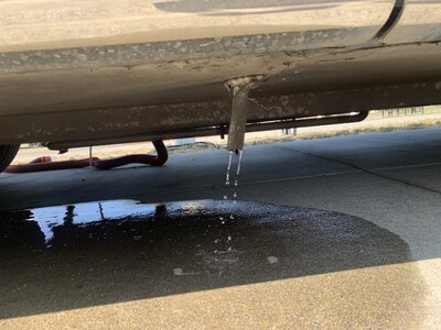

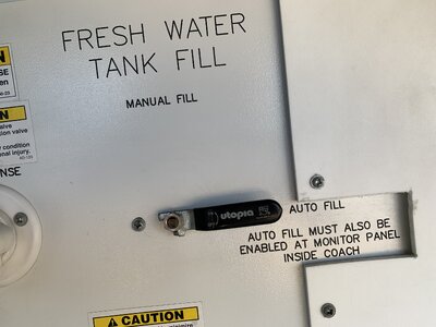

Walked around the coach last night after being parked for a few hours and hooked up to rv park water. I noticed water slowly coming out of the fresh tank overflow. I visually checked the tank and it was filled to the top. I shut off the park water and the overflow stopped. I never use the autofill feature and it is always off at the front control panel. The only time I use the valve is to fill the tank as needed during a trip and the valve is always left in the autofill position after filling the tank.
So, I’m assuming that the valve has failed allowing water to slowly fill the tank. Has anyone replaced this valve. How hard is it to replace and is it a standard part available most anywhere or do I need to call Newmar parts to get a replacement. I’m on the road for a couple of weeks and would like to source one locally. Right now I can’t use the shore water without the tank overflowing.

I just went through the thread you suggested. I have never once used the autofill system. Is it still possible that the electrical valve could open when it’s never been in any position except closed? Really?? That’s why I thought it might be the mechanical valve that is leaking.
It could be a number of things for sure, some have simply cycled the manual fill valve on/off a few times and fixed their issue. I don't know if the valve is "normally open" or "normally closed" as I haven't reviewed the thread in a while.
Fresh water pump leaking through is the usual problem. Shut off park water and run on your tank for a couple days.
