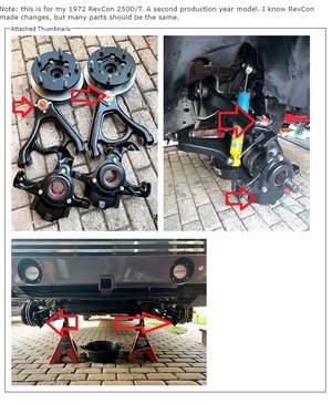

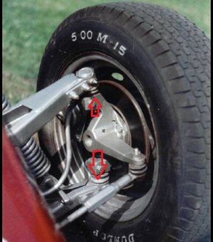

Ball joints are located above and below the axle outer CV joint. The ball joints attach the upper and lower A arms (Looks like an A) to the steering knuckle (the part the axle goes through).
Here is a clear picture of the Ball Joints on a different vehicle.
