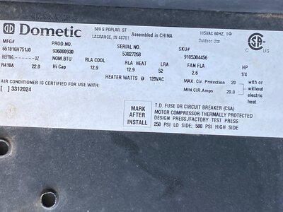

Also look at the rated RLA (amp draw) on the sticker on the unit and the test the amp draw while its running to make a comparison (see pic). I had one running at really low amperage and that indicated that the charge was gone so the compressor was spinning freely and thus not working hard enough to draw the rated amperage.
