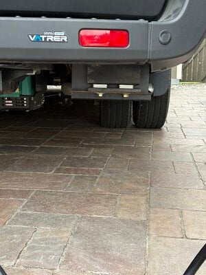

I decided to replace my AGM 200 lb inefficient “pig” of a battery (330 Ah but practically maybe 150 Ah useable) with a Vatrer marine battery packaged in a beautiful metal case offering similar dimensions but 460 Ah useable power. The Vatrer 460 Ah comes with a Bluetooth BMS (with temperature cutoffs and heat) all at 100 lbs. In cold temperatures this lithium battery will deliver 4x the power over my AGM.

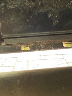

First thing was to be sure the Vatrer 460 would fit on the existing AGM battery tray. The horizontal dimensions are the same but the Vatrer is 3/4” taller. So I incorporated two spacer metal bars-the one on the forward side is a half inch metal spacer bar. The spacer bar on the back side included additional half inch spacer so that the battery sits level.
The terminals were the same size so securing the cables was a simple task.

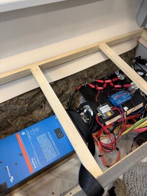

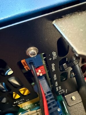

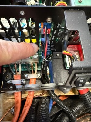

Initially you need to remove the driver side bench top to reveal the Inverter, remove the forward cover (two small screws), and be sure the inverter is powered on. The first thing that needs to be done is change the white toggle. This is something that Grok missed but I saw in a video from Victron-there are three toggles and you need to change the second toggle to “on” and then move the third toggle to “on” and then to “off” to save the setting. So when you are through the 2nd toggle is on and the 1st and 3rd toggle are off. This is the lithium setting(find photo of white toggles).
Next connect the Internet cable from the MK3 interface to the open terminal (photo of me pointing to the location) and open the Victronconnect app. It will find your MultiPlus inverter and Cerbo GX. You need to select the MultiPlus and then go up to settings. It will ask for a password (the password is zzz). You will instantly see a list of parameter categories-like Inverter and charger.

One thing I noticed when I had the bench top off is Coachmen did a poor job or insulating the coach outside walls. I ran to Home Depot and put is another bin of rock wool insulation against the wall and floor on the driver side and the passenger side protection the freshwater tank and bed (just the outside walls-keep the inverter bay open for cooling.
