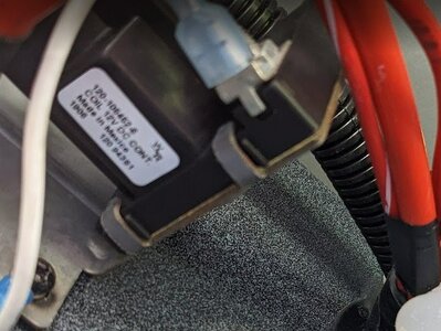

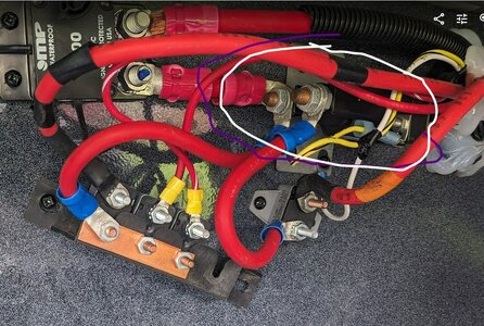

It appears that most people upgrade their BIM's to the Precision Controls Li-BIM 225 unit. After searching all the RV I don't believe it has a BIM but contact solenoid relay (Pics 1 and 2). I t appears to have the positive lugs and ground wire without SIG and IGN wires or connectors.
If anyone can confirm this for me that would be great or if there is anything I'm missing here, please let me know. Thanks.

Yes, you will need to change the solenoid for a BIM, and the 225 you mentioned is a good fit. The reasons for this, you may not have run into yet. = first, if your Li battery is very low, it will pull what it can from your truck battery/alternator when you key on and the stock solenoid closes. That could be 200+ amps, which can overcome your stock wiring, hurt your alternator, and cause a wire fire etc. Some are fused properly from the factory, and some are not..... Then, even if not super low, the stock solenoid likely stays closed all the time, putting a heavy load on your alternator for far too long.
The 225 will cycle on and off, resting your alternator. It will also maintain your truck battery when plugged in. If the wore size doesn't support, go with a DC to DC.
Since you already did the MPPT and the converter/charger, the only other thing to consider in this upgrade is a shunt to get true SOC from the battery. Like a victron smartshunt - if your battery and negative lead is under the van, they have a waterproof bluetooth version now.
