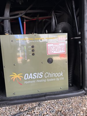

-I do get the fault code on the inside panel next to the burner button but I do not get any faults or red lights on the unit itself, inside the bay.

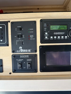

So looking at the front of the Oasis around the push button, the paint seems to be discolored (or is it just the pic) if it is, is there an internal exhaust leak? Just a shot, but if there is I would think it would overheat the components inside and cause problems. It would make sense that you say it works for a bit then starts acting up.

@scottramer
Good catch, I haven't noticed that until you pointed it out. I will go check to see if it is something with the camera or actual burning and come back with a status.
