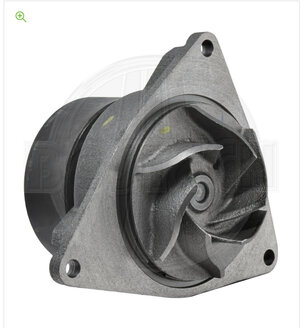

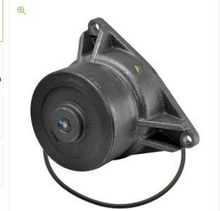

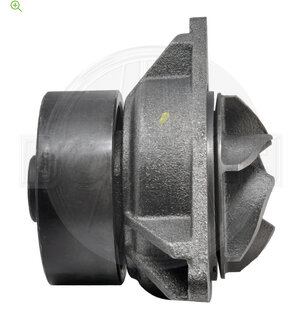

What pump is this exactly? When I mentioned "water pump" with FL-Gaffney today for possibly replacing mine as I'm approaching 60K they said it's a "house builder part". I replied I'm not talking "water pump for the house but the one for the coolant for the engine" - they again responded that this is something Newmar installs. I need to know more specifically what to ask for to have pre-emptively replaced to avoid the above situation.We were out of the shop at 9:45 with an invoice of $880. The pump was about $350 and the rest labor, extra small parts, fluids and taxes. Not bad.
I asked to see the failed pump.
The center bearing totally failed and the shaft was cocked to one side. The visual inspection the same morning did not give me any indication that something is failing, like weeping or wet spot on the engine.
What surprised me was the impeller. It is made of black plastic with the strength on Tostitos corn chip. The blades were breaking off with little effort just using my fingers (photo).
The pump is not rebuildable and basically trash. I feel component like that should Last more than 60K miles. Specially in light use. I always cruise at 65 max.
That’s the end of another chapter. Slowly heading South to Florida.
They were confused. This is an engine part from Cummins plain and simple. I’d tell them its the one thats run by the serpentine belt on the front (well back in our case) of the engine. They probably just don’t get that request very often, if at all, so they were thinking pumps other than the engine water (coolant) pump. But that is odd….What pump is this exactly? When I mentioned "water pump" with FL-Gaffney today for possibly replacing mine as I'm approaching 60K they said it's a "house builder part". I replied I'm not talking "water pump for the house but the one for the coolant for the engine" - they again responded that this is something Newmar installs. I need to know more specifically what to ask for to have pre-emptively replaced to avoid the above situation.
