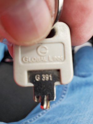

Has this happened to anyone else out there? After a wonderful first trip in our RV, I managed to break the key off in the storage compartment with the generator. Unfortunately this key is the key for all the storage compartments which I managed to lock before I snapped the key off in the lock. This was the only key I was given for all of our storage compartments. My question is where can I get another key, and how do I go about getting another lock or should I have a locksmith get the broken key out. I have attached a picture of the broken key. Thanks for all your answers in advance!!

I would suggest a dealer for a new key. That number on the broken key is what will give them the info. far as the broken part you may be able to slide something in beside the broken piece to work it out.........

Go to camping world, with the number on the key and get a new one! Most of the time they have them in stock!

I want to thank all of you for your replies and ideas. I called the dealer and they happened to have a couple extra keys and just gave them to me. Now wish me luck I still need to get the broken key out of the lock.
Go back to the dealer and buy the cylinder that matches the key!! It takes 5 minutes to change it out!!
Another option take a price of bailing wire use a drop of super glue on the end, hold it on the thickest part of the key, allow it to fully harden and then try to pull it out.
I know you’ve solved your issue, but believe it or not this morning I went to open one of the compartments with the exact same 391 key and it broke!
I was going to try to use super glue to get it out of the cylinder but instead I tried using the wife’s stitch ripper!!
I slid it in the side to and it moved the key on an angle, I then took the point and pushed down on the top and was able to pull the key out!!
