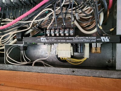

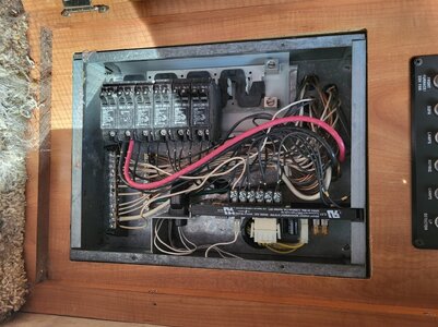

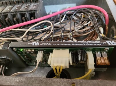

I pulled my electrical panel cover, which is next to the battery storage and there is something in there called a smart energy management system. I'm researching that now.
Pulled the cover off of my electrical panel and this is what I found. (photos attached) I'm researching this now to see where it leads.

That is managing the AC usage thru the white wire that runs thru the loop. It is a priority system. Your converter is probably in behind it.

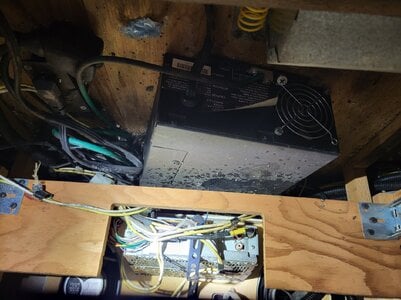

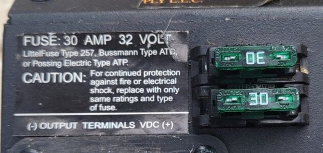

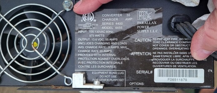

For everyone offering help, thank you. I finally located the converter. It was "mounted" under the kitchen cabinets. You had to remove the lower part of the cabinets and a drawer to access it. It was about 4 feet from the fuse panel. I can guess what the issue was, at least in part. It was covered with mouse urine and filled with droppings. The previous owner didn't do much maintenance I guess. Now it's time to research a replacement. (not sure why the last image is upside down)
