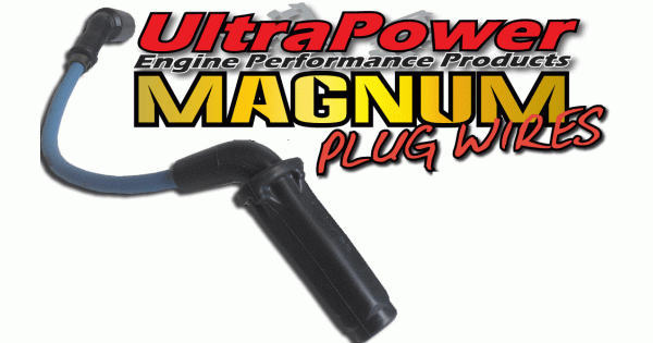

The 8.1 Vortec has spark plug wires that run atop the manifold. They get very hot and lose performance. You need to buy these (below) and replace your existing plugs and wires. It should solve your issues. (now let's see if I can find the link 🤔)
