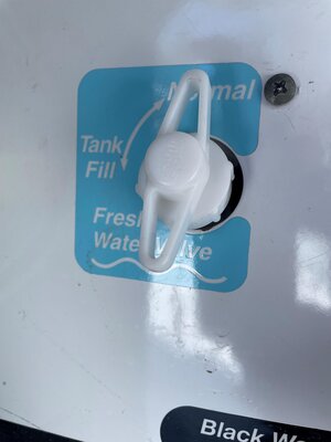

If your system is like mine, and it sounds like it is, then you probably have a two way valve that directs the flow of water to the fresh tank or by pass directly to the plumbing. My valve malfunctioned and I had the exact opposite problem. I could not fill my fresh tank. The condition result is just how the valve was positioned when it failed. Replacing the valve was fairy easy but making sure I got the correct valve was not. I had to leave my plumbing apart in order to match the broken valve. See the photo of my valve.
