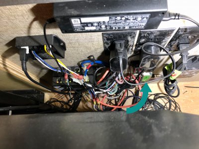

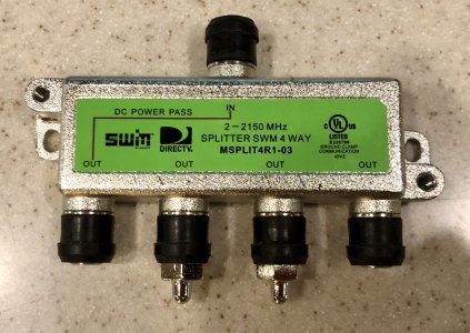

Today I located the splitter on my 2018 3341...same location as Ward indicated. The attached picture shows the many wires, cables, controllers and splitters hidden in the televator cabinet (the arrow points to the coax splitter prior to removal). The picture was taken after removing the cover as Ward suggested. My reason for swapping the splitter is due to changing from DirecTV to Dish...I can't receive one of the satellite signals when going through the splitter...when connecting a cable directly from the roof to the DIsh, box the signal comes through. As you can see, the removed splitter is specifically designated for DirecTV. I have a splitter on order that is supposed to work with Dish...stay tuned..
