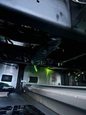

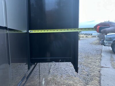

Hello, I am asking for help. We just bought a new 2023 Tiffin Phaeton 36SH. When we went to look at the RV the passenger side rear slide would not fully extend due to a broken hydraulic hose. The dealer said they fixed it when they dropped it off at our house but we do not think the slide is fully extending.
If somebody could measure the outside of the rear slide when extended, we would be very thankful. Also, we see cables in our main storage bay. We are not sure if this is common or if the service department did not put panels back to seal the wiring. Could you take pictures of the roof of the main storage bay that has the slide out storage. Do you see cables or are the cables completely enclosed.
We would greatly appreciate your assistance. Thank you in advance.

As far as the slide goes, check the seal behind the trim on the inside when the slide is open. It should be tight against the interior wall. If not, it is not open all the way and there may be something hidden that it stopping it

I am attaching two pictures to show what I am describing.

Wow. If those are the only two issues you have Congratulations. You will have more. Best advice for slide is measure both ends outside when extended to see if they come out same distance. Also check inside both ends to see if it is fully extended. Two possibilities bad motor or slide not synced.

Hi and Welcome to RVforums and the RV life. As others have mentioned these type of issues are to be expected. The slide extension, check on the inside wall and see if the slide it tight to the wall if so, it is fully extended if not you have an adjustment issue.

I would not worry about measuring the outside. Go inside and where the slide out meets the wall to see if there is a gap. Now the trip will not hit the wall, but behind it is a seal that will. If it touch’s your fine.
For the storage area if you see holes around the edges of the storage area to attach a panel, they may have missed it, but holes could be there for other reasons too.
