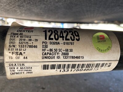

I want to replace the brake assembly in my 2020 Freedom Express Ultra lite 192RBS. I need to know if my brake drums are 1 1/2 or 2 1/4. I am trying to buy the replacement parts from eTrailer. Seems I have all the other information needed with the exception of this information in order to put my order in.
You have two options!
Climb under the rig and get the axle number, or pull a drum and measure.
No one can know what the build order specs were.
Thanks! I did take a picture of the tag on the axel. I am surprised the eTrailer person didn't know to ask for that information. I assume the 1284239 is a part number they should be able to cross reference to get the brake drum size?
Came from dexter as a complete assembly.
