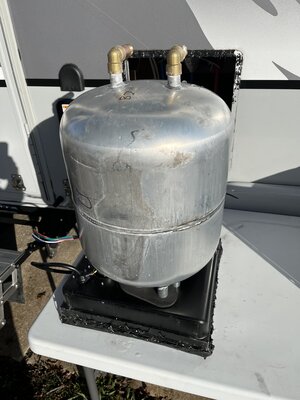

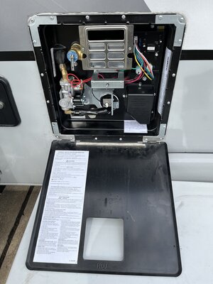

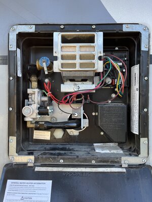

Hello, We have a model 2375, year 2021 unit. The WH-6EGA water heater has sprung a leak. Clearly appears to be at the resting point for the tank on a thin walled petition opening. This point of contact seems by design harmful to the aluminum tank.
Has anyone experienced this failure? We’ve put a lot of miles on our Lance in a couple years.
Thank you in advance.

Does the water heater ever get turned on with an empty tank? This is very tough on the device and it overheats.
Rick
Is the leak the holding tank itself or one of the crimped water lines?

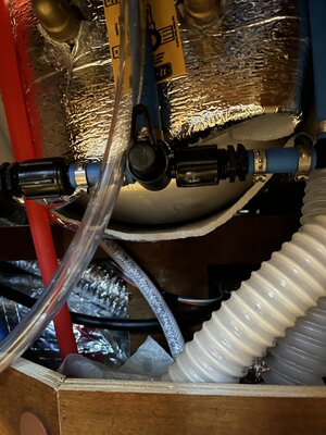

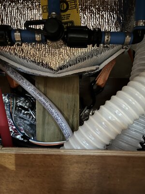

I haven’t pulled the tank assembly out yet. New replacement will be here this Friday. We’re on the road so I’ll hold up pulling it until the replacement arrives. It clearly appears to be from the tank or possibly one of the welded tube connections to the outside panel face. It’s a pretty severe leak.
It’s a free standing tank. Seems like this allows for the tank to flex from road jounce on the tubing connections to the face panel. Just doesn’t appear to be a stable platform for the tank. I’ll be making a larger more stable platform to include a strap tie down system.
Thank you for the reply.
Henry
Rick
We purchased new so to my knowledge this hasn’t happened. Is this something that can result in a leak?
Henry

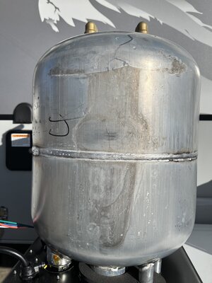

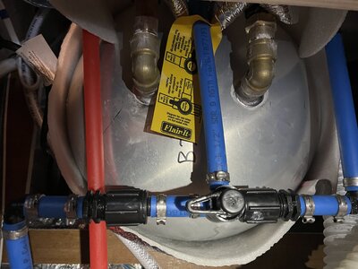

It is rare that a tank leaks. I have seen bad welds on a Suburban steel tank, and I would be more inclined to think you have a leak at the cold inlet or hot outlet. It is not where the tank rests on the support. The aluminum is thicker then that.
The tank s currently isolated and drained. Definitely taking a closer look at the inlet outlet connections today. I’ll post what happens after testing for leaks.
Thank you all for the help.
Henry
Henry

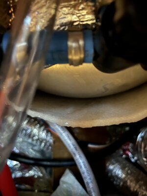

After refilling and pressurizing the system the hot /cold connections are completely dry. It s clearly evident the leaking at the tank resting point at tge petition cut out. Hard to see in my picture but up close its easy to see water bubbles out on the insulation.
