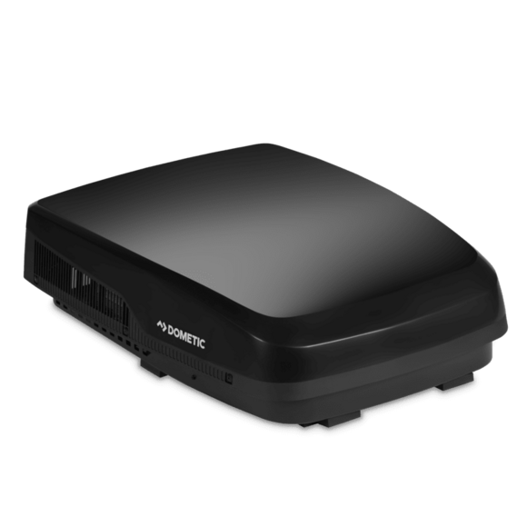

The new Freshjet 5 does not look like a big improvement. Blue coating on evaporator fins, separate housing for capacitors, maybe an aluminum base rail…which hopefully won’t rust out like the Penguin II. Slight styling difference on the housing cover.
