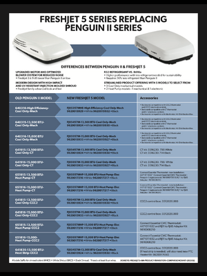

The new Heat Pump versions are available. And a piece of literature that shows the wiring for those of us with CCC2 RJ11 communications. It appears to me I could replace both Penguin IIs with Freshjet 5 .,,keep my original thermostat wiring, and just convert to connect to the Freshjet control board. Much easier than what ai was oringinally led to believe. The remaining controller in the basement for AGS would be unaffected by the change.
It appears the choice will be 13.5 or 15k but, a/c only or heat pump, mechanics only or electronic …which I believe the mech requires a separate controller in it’s own metal box… and the electronic version I believe has the built-in control board. Still another with the heat strip option.. For Newmar people looking to replace Penguin II… the 15k electronic control Heat Pump, your choice white or black… and it will take two of the RJ45 to RJ11 connectors. Our coaches have RJ11 and CCC2 thermostat compatibility. The new Freshjet 5 is actually designed to accept RJ45 comm cabling and uses Canbus language…but they show it being able to still respond to CCC2 …the hitch is the comm port doesn’t accept the wiring we have without an adapter.

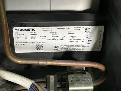

Hmm.....I didnt read through all of this, but it caught my eye because we actually have a Dutch Star in the shop that got a full solar/inverter makeover, and during testing we found the rear Penguin 2 had an internal blockage and needed replaced. We expect to receive the replacement within a week - supposed to be plug and play....we will see...

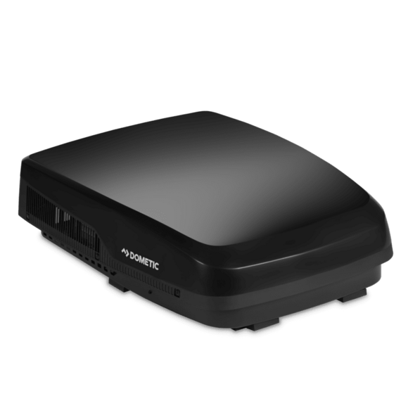

Dometic FreshJet 5 Low Profile ELECTRONIC RV Air Conditioner WITH HEAT PUMP 15,000 BTU - BLACK - FJX5557EHPBKCS
High amp and no flow pic as well as existing PN placard attached for ref.
