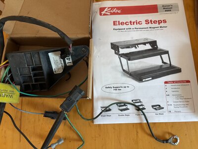

Late to the game, but have you pulled the motor off yet? I believe its just 3 bolts (don't loose the spacers). The motor is easy to test. Just jumper the two wire connector to a 12V battery. Doesn't matter which is positive and negative. One way will run the motor in one direction and the other will run it in the other direction. Just use some alligator clips to hook up to a 12V battery.
As for the controller, the one I bought off of Amazon came with the other half of the 4 pin connector which made it easy to test the existing controller. Just apply 12V and/or ground according to the troublelshooting manual.
I bought a controller off of Amazon and found that the override function did perform correctly. It retracted the steps when the engine was started but did not extend when I opened the door. Anyway, just make sure you thoroughly test after installation.

I made it work good enough. I ended up adding a relay so that when it sensed the correct condition in the override or door wire, it would open or close or whatever I needed. It was a few years ago, so I don’t recall the exact configuration. The change was on the controller side of the 4 pin connector, so if I ever have to change the controller again, the changes I made will be removed along with the old controller.

Gentlemen, I am Happy To Report - Kwikee Electric Step In Now WORKING!
The culprit was the controller. Coupled with all the help from you guys and following the trouble shooting instructions in the Kwikee Step Owner's Manual we are good to go. Just in time for our departure, Monday. Full disclosure, I order both a controller and a motor. The Amazon sourced controller showed up in two days. Ordered the motor from AM Equipment the day before I ordered controller and it's not here. The AM Equipment product is an exact OEM replacement, so it was the right thing to do. But if the motor was the issue, I would be in a pickle.
Fortunately, I did figure out a way to get the step out and lock into place. But it was truly "backyard" engineering! :) :)
Thanks again for all the suggestions/recommendations and personal experiences.
