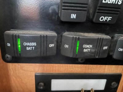

I'm not familiar with how Thor configures power but back when we put our coach into storage, we just flipped two switches and walked away. This killed anything electric I believe. More than three months later we flipped them back on and had no issues. See pics of our switches (I think they are sometimes known as salesman switches).
