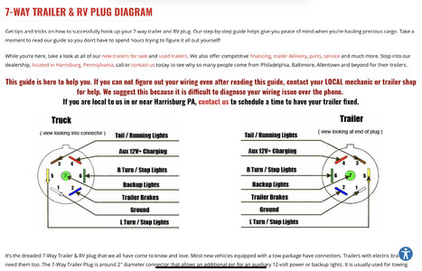

Its pretty common for chassis manufactures to leave the 12v power connection in a round 7 either unwired, or without a fuse or relay to power it. That would be #4. If that’s the case, to fix that you would first locate the fuse or relay space for that and see if its in place. If not the fix is easy. On my F250 there is a spot for a relay in the fuse block but it isn’t wired and doesnt have contacts in the block (from the factory - lame!) so it would be a bigger job to fix and I just live without it.
The #7 is back up lights, so that may or may not work but unless you have them on the trailer you wouldn't need it. Is this vehicle new to you? Did they ever work?

I’m certain its not mentioned in the owners manual (probably is in a shop manual), but if you look at the fuse location diagram on the back of the fuse block cover you might find a listing for 12v trailer power and a corresponding empty fuse slot. A quick call to the service dept of your local dodge dealer should also solve that part of the mistery.Our is on a 21 Promaster chassis and we have what I believe to be 5" screen. I have gone over the manual front to back and can find no mention of turning off backup sensors other than connecting a trailer, and no mention of any trailer light fuses.
