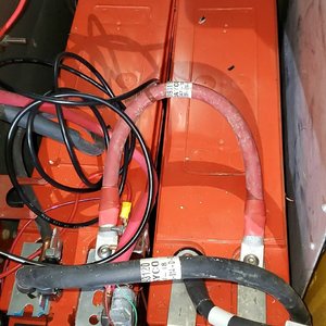

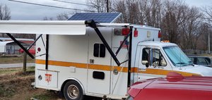

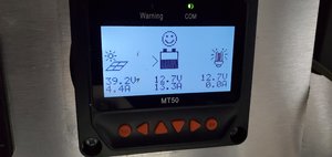

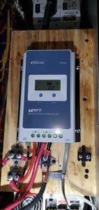

I currently use a EPEVER MPPT Solar Charge Controller 30A Tracer3210AN + Remote Meter MT50, the system charges two 200Ah AGM batteries from 2 310 watt REC solar panels. I am fully charged within a couple of hours after sunrise, even if it is overcast. I have yet to plug into shore power since I put the system online.
