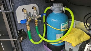

MOD Finished the softener install

Didn't like the idea of having to move, hookup, and unhook the OTG softener so I plumbed it in to fit in the next bin. Valving allows bypass and quick disconnect. Still easy to pull for regeneration. 20200226_155435.jpg
Very nice! If I only had 10 more basements!
You do nice work Jim!
