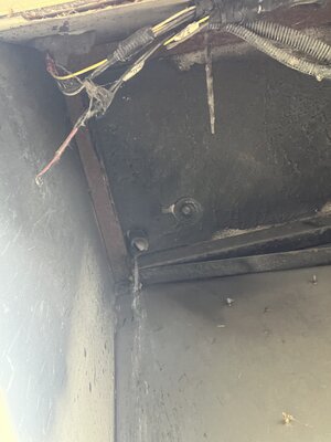

I have a 2021 Holiday Rambler Admiral 35r. I am trying to find where the freshwater tank drain is located. Also, when I try to fill the fresh water tank the water starts coming out from a hose underneath on the back left. Any help would be appreciated.
Is the hose in theback the overflow? The drain should be right near the tank. In some coaches it is behind a panel.
It is leaking from a hose in the back underside. I attached a picture of it. I really don't know where the tank is, I assume maybe above where the hose is leaking?
Could be an overflow. Is your tank reading full? Thetank may be in a bay. Behind a panel, or I have seen them under the bed. If you don’t see it call HR.
AbdRahim, just an update. I did speak to HR today as you suggested and found out that the tank, shut off valve and the pump were under a panel under the bed. After removing, I found that the valve was open which is why it was leaking back out. Thanks again for the suggestions.
