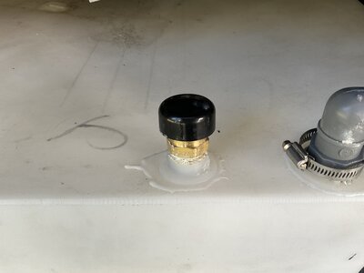

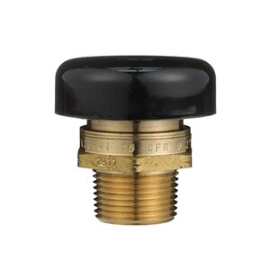

It probably doesnt have a tube coming from it - probably just a vacuum relief valve on top of the tank somewhere.
There must be a vent at the top of the tank. Unless they made mistake and missed installing one?
Look for one of these:
