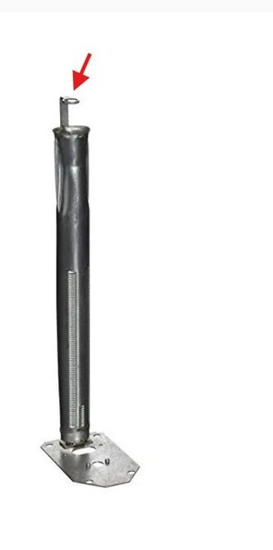

@scotticus614 Mine is doing the exact same thing. Different model heater (Airxcel). Did you ever find out what was wrong?
ok, found a solution...sort of. lol
Suburban Furnace Model NT-16SEQ or NT-20SEQ
Fan starts
Furnace Ignites without a problem
Loud rattle for about 5 seconds after ignition of flame, then normal function
same loud rattle after burner goes out when reaching temp, fan continues to run normally until stop
Video of startup sequence with rattle attached
SOLUTION:
*** take burner out, put it back in *** ????
we removed front grill
then removed front plate of burner housing
pulled out the burner assembly...inspected inside....looked puzzled...reinserted burner assembly
replaced front burner housing plate
replaced front grill
problem solved! kinda like...turn it off, then turn it back on, eh?
we think maybe the nozzle hole/stabilizer was the source of the rattle. perhaps reinserting it reset it to the correct position so that it wasn't knocking. See image of burner assembly attached.
hope this helps someone else. I'm looking forward to not waking up every 15 minutes when the heat cuts on tonight!!! :)
