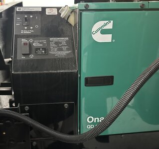

As to running on GEN the Cerbo GX new UI has great info and can show you the watts in, watts out, etc. You can look at the detail of supply and demand easily. Also VRM has numerous charts you can use and learn how it works and manages the loads, charging, etc.

Your victron is only as smart as the data it has. Victron does not monitor any other loads. According to the documentation, the line rate limit is how the max rate is set. This is identical to magnum, and only the wording is different. If you set to 30AMP line, it will consume 30amps during a bulk charge. The instructions are very clear that you should set this low enough to allow of other devices.
With a charge rate of 30 amp, and ignoring all the other consumers of power, you are taking 30amp from L1. If you have a 2nd charger, and its installed properly, then it will take power from L2.
When being stored, or only using 12v appliances, you can safely operate at 30 amp and never have a problem. Having any other power consumed from the power will also take power from L1+L2. The EMS job is to adjust the charge rate as part of charger before it shunts power on other devices. It will shunt power, but the timing can sometimes be too slow.
There are other power sources that do not have the ability to shunt. The refrigerator, outlets in the RV, etc.
With a 10KVA, loads of 8amps can be enough to trip the breaker. With a 7500KVa generator, 31.25 is the max amps.
