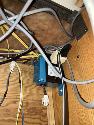

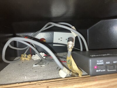

So based on these photos and I’m a little slow to notice these things, it appears that there was some rewiring done. This yellow wiring doesn’t seem to go along with the rest of the wiring of the coach. Looks like it’s wired to the entertainment area here and as you can see, it looks like a new box was put in and the wire goes to a receptacle or outlet on the left-hand side no doubt for the VCR on the right side. It looks like they wired the power antenna to 12 V? I’ll have to shut down 12 V to determine that, although it may just be wired into 110 but there’s no presence of 110 power in any part of the coach here so probably 12 V

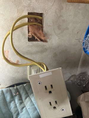

So the yellow wire at the kitchen receptacle seems to be from up the up the chain and there is no outlet in the toilet bathroom area and there is no outlet between the Breaker box and the kitchen receptacle. This is really confusing and I’d have to take out the GFI outlet in the vanity area again and take a look and see if it’s wired to the yellow wiring. I don’t know where this yellow wire is coming from. I can’t see through walls so I’m not sure how to proceed , I can put a GFIC outlet where that other regular outlet is in the kitchen's, but I still don’t have a live wire there if that makes any sense? The one thing I have to ask myself is could there still be an issue at the breaker box despite the limited testing of swapping the refrigerator breaker for another 20 amp breaker and detecting voltage at the breaker?

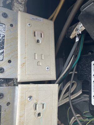

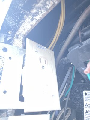

Is there something else I need to test? A question it just came to my mind is could the kitchen outlet be damaged from the hot plate and would putting a GFI outlet there make a difference but again if there’s no presence of power in either of those wires and how would that work? One last thought where the microwave is plugged into above the microwave it’s an outlet and it says inverter and that is a functional outlet. That’s where we’re powering the microwave from and we have also ice machine plugged into there as well. We’re not using both of the same time but dumb Probably has nothing to do with it one of the thing that comes to my attention again slow to notice these things is that the one of the two outlets that the refrigerator plugs into is a GFI protected outlet is what it says no no way to reset it and if you take a good look at it, it looks like it was a heat buildup there. Kind of an imprint not really sure what’s going on there but if that outlet is out that would break the chain I’m guessing and it is out there. There’s no power coming from it so I’m gonna take that apart and take a look at it and cause there’s nothing coming out of that and maybe that’s what the problem lies. I don’t know but your guess is as good as mine.
So as you can see in the photo, the yellow wiring is wired into the refrigerator outlet. I wasn’t able to pull that outlet all the way I’m not getting any slack on the wiring ha ha wait a minute OK so I’m gonna have to follow these wires if I can but yeah, it’s definitely wired into here and figure out where this other wire is going, maybe the water heater that would be the next thing up the line up the chain and the water heater does have 110 so I’ll report back

I’m gonna get over to HF as soon as I can, and pick up that that cable tester also I just discovered with a NCV tester, that there is line power coming from the yellow wire to the GFIC outlet by the vanity sink. I tried measuring on the multi meter but I think the meter is not working, right. But there is power coming from there so that leads me to believe that the GFI outlet was either wired incorrectly with the line going to the wrong connector or the GFI outlet is not functioning properly one thing I can do is connect the GFI outlets to the other RV and see, if it’s working properly, I’ll report back as soon as I know more .
I picked up the cable tester yesterday, but looks like I'm not going to need it this time.. Today I rewired properly the GFICI outlet and we have our power back in the front of the the coach. I can only come to the conclusion that the outlet was wired and improperly and with my limited skills, I did the same but after finally realizing that both the black and white line wires come from the same yellow wire I wired the line and load properly and the end result is we no longer have an issue. Now I can put my attention on the 12 volt issue that hopefully will solve some other issues.
