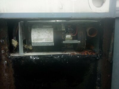

I hadn't thought about mice, lately I've been hearing scratching inside the bedroom but it went away. I was thinking the shaft could be loosened it looks a little wobbly, so I can access it outside, the motor seems to be held by just one screw in a bracket do I need to take the whole blower out to reset the shaft? I'm attaching a photo and I also have a video if it's not too big I will try to upload it.

That is the exact unit I had mouse problems with for a customer. But they also covered the return air for it and it overheated and warped the squirrel cage blower and it blew apart after it hit the sail switch. Why are there leaves in there? Considering the age, I would put a core replacement in as I did for that client. It is more then 1 screw, but not hard to remove.
Take pictures of your wiring carefully to plug it back in right if you replace it.

So the sail switch could have been affected by the blower? That could explain why there is no heat. To answer your question, it looks like leaves but it's actually rusted pieces of rusted pipe from the bottom exhaust I think it must have broken when I pulled on the face plate. So the only way to get to the squirrel cage is to pull out the whole thing? Is it more likely the shaft since, there hasn't been any squeeling sounds or anything before this? Thanks
Your sail switch is just above and to the right of the middle, it has a "sail" that protrudes into the blower housing. By the looks of the unit and the fact that there are large flakes of rust involved, it may be beyond your ability to repair. There are more then one screw holding the outer housings over the 2 blowers. The one on the right is combustion air and the one on the left is circulation air for heat. One motor drives them both. If the blower is not spinning with the shaft, either one that is, it will not work. The circulation blower must spin fast enough to close the sail switch or it will not allow the gas valve to open.
There is on screw just right of center on the bottom that holds the guts of the heater in. The outer box is just a plenum to heat the air. Take care to know how the wires go if you remove it. It plugs in and will come out withouot cutting any wires.

I understand what are you saying about the large flakes of rust, but it's not like it's it's an unknown, I know it's the exhaust pipe or tube that comes out and connect to the face plate, the question is can it operate with part of that pipe broken, or is just best to replace that pipe if I can find a replacement part. So if the blower is making that racket chances are it's not spinning fast enough to close the sail switch. Well at this point we have 1 more cold night and than we have a warming we managed with the little space heater we have so, I'm going to put it on the back burner for now, no pun intended. But I have the screws out and the cover off and it seems like the most logical thing is to repair it and do a maintenance cleaning on the whole heater, as to whether I will DIY it or I hire someone to, remains to be seen due to the high cost to get someone to come out to fix it. One question, what is that black goo tar like sealant that goes on there? Is it some kind of HVAC specialty stuff?
I am not sure what it is, the picture is bit out of focus but it looks like it was slathered up with some tar substance after it left the factory.
I would say no for safety as that is the exhaust pipe and it MUST exhaust outside the unit. Some units will not run well with out the pipe in place.

New development, I getting warmer now so I went to take a look at it again and examine the insider of the squirrel blower, at first I though there was one of the mud buildups in there, than I thought it was wasp nest, I reached in with a spade to try to scrape it off, but it had some wait to it, turns out it was a dead mouse, no doubt the one we had in the coach up till that fateful moment when it got in there and gummed up the works. I removed it and tested and sure enough the noise/vibration is gone, at the time the propane was on and we noticed a slight burning smell coming from inside the vent. Immediately turned off the heater and turned off the propane, not sure if that was causing the smell. No smell of propane was detected just that burning smell. Could it be some debris from the blower? Could the mouse have chewed something up? Now as for the exhaust let's call it exhaust pipe, no doubt that's connected to the furnace correct? That tube the removes though over the exhaust pipe. so in theory wouldn't it still allow exhaust to escape? I do have multimeter but given the latest development do I still need to test with it? Thanks
