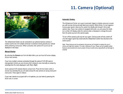

Got to the settings area on your display there maybe a camera option. At least mine does and that is where you can turn them on and off. I set my rear camera on to run all the time to see my toad.
I do have the camera settings. I see where it says turn on Rear Camera with an option of off and on. Do you simply turn that to off? I do not see any other options. Thanks for the help.

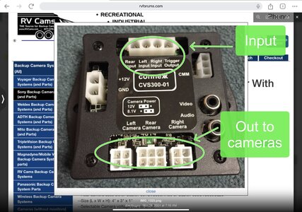

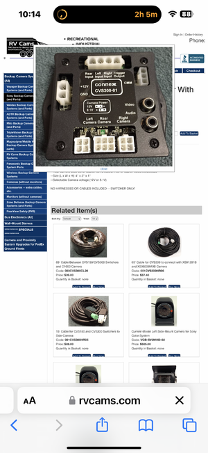

I’m not positive on your NA but if you think about it the left and right view of the lanes when turn signals are operating are not part of the 360 camera view. On my 2018 DS there was a separate module under the dash for the two turn cameras and the rear lower camera. I didn’t like the redundant rear camera views so I disconnected that wire from this module It was 5 years ago so I don’t remember exactly what it looks like.
I believe it is located right near the Xcite module
I lost my camera when I turned my left turn signal on as a result of a loose connection as I indicated in my above response. The photos are from a Newmar tech at the service center to help me get the camera back when using turn signal. You might want to check it as it would be an easy fix to plug it back in.

Now, did you turn the rear camera “on”?
Pictures of the screen would help.
