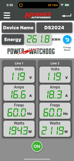

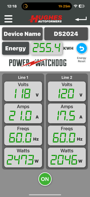

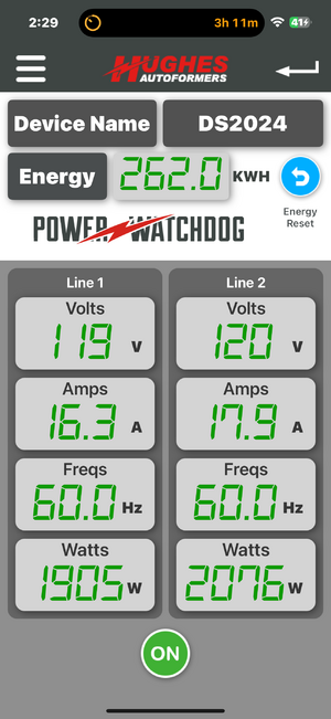

I’ve noticed that even with minimal utilities running, one ac unit and cooktop, we are pulling 50+ amps??
With the dryer running the pull exceeds 60 at times. Have yet to pop a breaker. ???

Autoformer app.
Noted that front ac is pulling way too much as best as I can tell. That along with unknown issues with Autoformer life is getting challenging.
Without front ac draws look more normal
Maybe a bad motor in front ac…??

No excess noise but looks like it pulls 25-30 amps continuously. Way too much.
The Autoformer is probably trying to sort out the difference in load between line 1and 2 which is substantial at times. Front ac on line 1.

IMG_1721.pngOnce the load is balanced between line 1 and 2 things seem to settle fown
You are drawing way too much power. Actually I am more concerned that your main breakers are not tripping. In my rig I can run both AC units and other appliances without tripping. My AC units each draw 13 amps each. This leaves 24 amps available for other items if you loaded to 100% of available power. While circuit breakers are built and tested to run at 100% of their rating they are listed to be applied at 80% of the handle rating. if you apply that rule that available current on a 50 amp service is 40 amps which in my case in practical applications leaves 14 available amps after you take away the 26 amps used by ACs when running.
