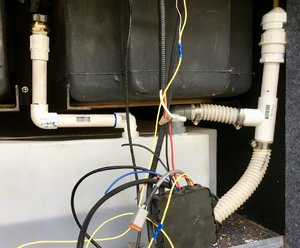

As far as breaking that siphon action, before I changed the overflow to stop this problem (below pic) I used to carry a short length plastic tube that I would slide into the overflow (as it was pouring out) and then blow in the other end. This would force air into the overflow and break the siphon... Not pretty, but effective.
