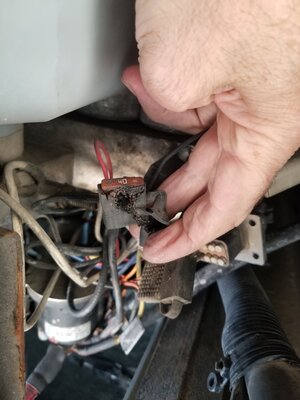

On September 16, my HWH hydraulic motor/pump blew a 40-amp fuse and melted the fuse holder. Of course, the pump stopped pumping and all things hydraulic ceased operation. After replacing the fuse and holder, it all worked again, but the terminal post to the HWH motor was wiggly and jiggly...not a good sign. So, on the 18th I called Newmar for some diagnostic assistance (replace the pump, she said) and a quote for the new part (I'll have to get back to you, he said).

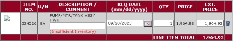

9/27 - Jacks up, and uh-oh, FWS isn't coming in...the pump went 'legs up.' It's beginning to look like we may be late to the Newmar International, just over 500 miles away. Coincidentally, the Newmar parts quote arrived today...$1,964.93, plus labor. 8-10 days out. And, just 10 days to get a price!

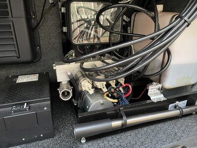

Search, search, search the internet...thank you, StarLink! And I find a possibility...Stuart's Service in Elkhart, IN. I call and speak with Chuck, the owner. An incredibly helpful gentleman who lead me and my volt meter to troubleshoot the problem and verify that the motor has failed. And, yes, he has one in stock. And, yes, he will ship it overnight via UPS. And, holy crap! It's only $409, plus freight.
