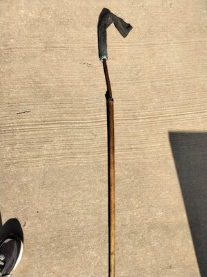

I made this to wipe down the jacks prior to retracting. It is a broom handle with a hole drilled in the end. Bend a piece of copper tubing and sew a microfiber towel with a channel to slide over the tubing.
It is time to replace the towel.

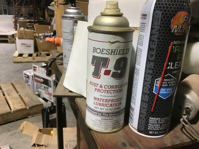

this is what they used in the shop when I was there:
They recommended it but I never tracked it down and bought any.
This is a good product and I used on my table saw regularly. Didn’t leave a residue that transfers to the wood.
