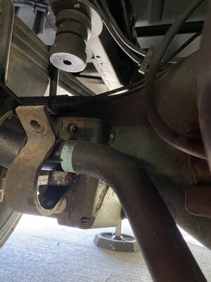

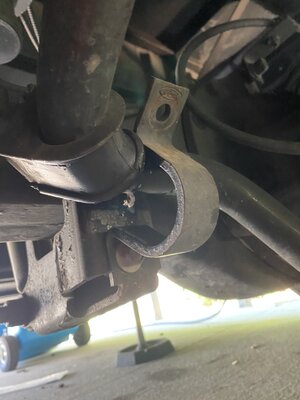

Upon checking the zip ties underneath, I found this.
The rear sway bar mount lost a bolt, bent, and was doing very little to keep the sway bay in place and doing its job. The bolt backed out and was gone. One bolt held the mount in place and the bushing slid over to one side.
Our recent trip to Texas nearly neat us to death on I-10 and we had some pretty bad winds. The last trip to Tennessee was pretty uneventful, so I think it happened on the Texas trip.
However, this was discovered simply be me looking around with some fresh eyes and when I was not tired.
Look all over when you’re checking your or anyone else’s work. This could have caused more problems down the road.
