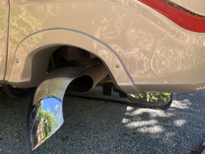

Thought I would post a photo of my RR and exhaust tip. As you can see there is no damage to the coach whatsoever after 30k+ miles with many long steep climbs out west.
